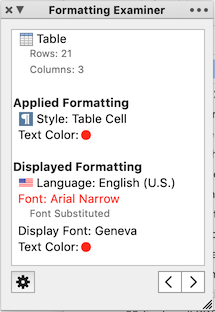

The core problem here comes down to fonts. Nisus Writer doesn't directly increase the line spacing or raise your text because of the overbar. The problem is that the composed character q̅ is not supported by your document font. Arial Narrow cannot display q̅ in your text. Whenever this happens Nisus Writer must choose another font to show your text.
This process is called "font substitution" and the newly chosen font is called the "fallback" or display font. If you select a character like Ꜫ in your document the Formatting Examiner should make this situation clear:
You can see that Arial Narrow has been substituted and replaced with Geneva. These fonts have different intrinsic metrics (eg: height, baseline, etc). That's why your lines of text no longer match up.
The ideal solution is to use a font in your document that supports all the characters you intend to type. Otherwise I'm afraid you're stuck fiddling with the line height and baseline to try to match things up visually.

In this particular case, that doesn't work. It forces the line to a certain height, but it doesn't put the baseline in the right place, which was my real problem.
Martin didn't really have an answer, because there doesn't seem to be ANY font that has all the miscellaneous symbols needed to transcribe medieval Latin -- but I didn't know of the "formatting examiner" palette he pointed out. That at least gives me a diagnostic tool for when fonts get substituted. It's a help.

in regards to Formatting Examiner's ability to detect font substitution I made a quick test (using OP's document).
It seems that FE is detecting the substituted font for main text but not for text inside the table.
Am I missing something?

Also, when I select that glyph, the Formatting Examiner does not indicate that a font substitution has occurred. It merely indicates a Displayed Formatting Font of Arial Narrow, albeit with grey diagonal hatching.
Next, I created a "Lorem ipsum" document and set all the text to Arial Narrow. Application of a combining overline to the letter "q" lowered the relevant line when Line Spacing was set at 1 lin but left the line unchanged when Fixed Line Height was chosen instead. This would appear to confirm Elbrecht's observation. I might add that, with Fixed Line Height chosen, the position of the line remains unchanged even when a combining overline is applied to a character with a high ascender, such as "b".
But in this situation, too, the Formatting Examiner gave similar information as before, with no indication of font substitution.
So, I don't understand what's happening in the Table. I don't understand why Elbrecht's suggestion doesn't work for waltzmn. And I don't understand what's going on if font substitution is not the whole story.

This is working correctly for me, in either a table cell or the main body text. Please try selecting the character fully. If there's no selection and you just have an insertion point (caret) the palette won't show that any font substitution has occurred, because no character is actually selected.
Re: Line spacing when using Combining Diacritical Marks
Posted: 2019-09-26 09:20:51
adryan wrote: ↑2019-09-26 03:38:17First, the vertical alignment of text in this cell appears to be Top, which would seem to be at variance with the line height problem seen when the glyph in question is situated in ordinary (non-Table-situated) text. One would have expected the text in this cell to be lower than that in the other cells in this row. According to the Table Cells Palette, all the cells in this row have Middle vertical alignment. Positioning the cursor in any cell in this row and choosing Top alignment does in fact move text higher, except in that first cell where its position remains unchanged. I find this curious.
The line of text in the table cell where font substitution has occurred is simply taller, either because of the fallback font metrics or font leading. That's why the vertical alignment matters less (or doesn't shift the vertical position at all). If you increase the table cell's height you'll see the vertical alignment still matters.
Let's just call this a bug. The Formatting Examiner palette incorrectly shows the mixed font state without the substitution indicator because of the composed character sequence (the overbar is a combining character). Even though the "q" is supported by Arial Narrow and the overbar is not, it's incorrect to show the mixed state because ultimately the characters are shown at once using a single glyph. I'll file a bug, thanks!

martin wrote: ↑2019-09-26 09:11:44 Please try selecting the character fully. If there's no selection and you just have an insertion point (caret) the palette won't show that any font substitution has occurred, because no character is actually selected.
Selecting the character inside a table gives the correct result for me as well but the discrepancy remains: as shown in my previous post, putting the insertion point (caret) right after the character causes the FE to detect the font substitution in the main body text while you need to select the character fully for text inside a table.
Are there any reasons for the different behavior?

johseb wrote: ↑2019-09-26 10:01:07 putting the insertion point (caret) right after the character causes the FE to detect the font substitution in the main body text while you need to select the character fully for text inside a table.
I would expect these to behave the same, so there's no good reason for the different behavior. I'll have to investigate, thanks!
