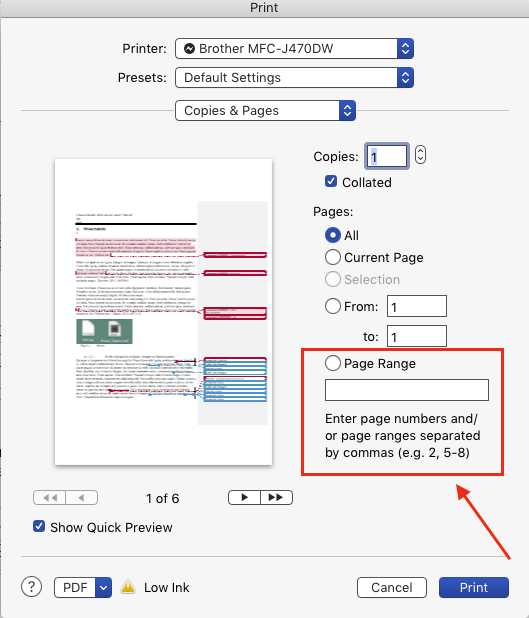

Maybe I'm missing something obvious here but how can I print e.g. pages 1 to 3 plus page 9 and page 12?
Word 2016 print dialog has a dedicated setting for this but the option is not available when printing from NWP3.
Screen Shot 2019-08-23 at 22.48.37.png (89.97 KiB) Viewed 36085 times
The obvious workaround is to create a PDF and then print only selected pages; a time waste especially considering that during long docs preparation such partial printing could be frequent.

I currently use a Brother MFC-J5730DW Printer. I looked at the Print dialog box for documents in several applications: in none of them was there a Page Range option such as that depicted in your screenshot — just "All" and From… to".
So it would appear that that Page Range option is specific to Word (which I don't have).

sorry for not being clear in my post; yes, that option is supplied by Word and it will not be available in NWP unless it is included as a new feature.

Good suggestion, thank you. The print dialog only has the "From" and "To" fields available for user input and both of them only accept a number (no commas or hyphens).
