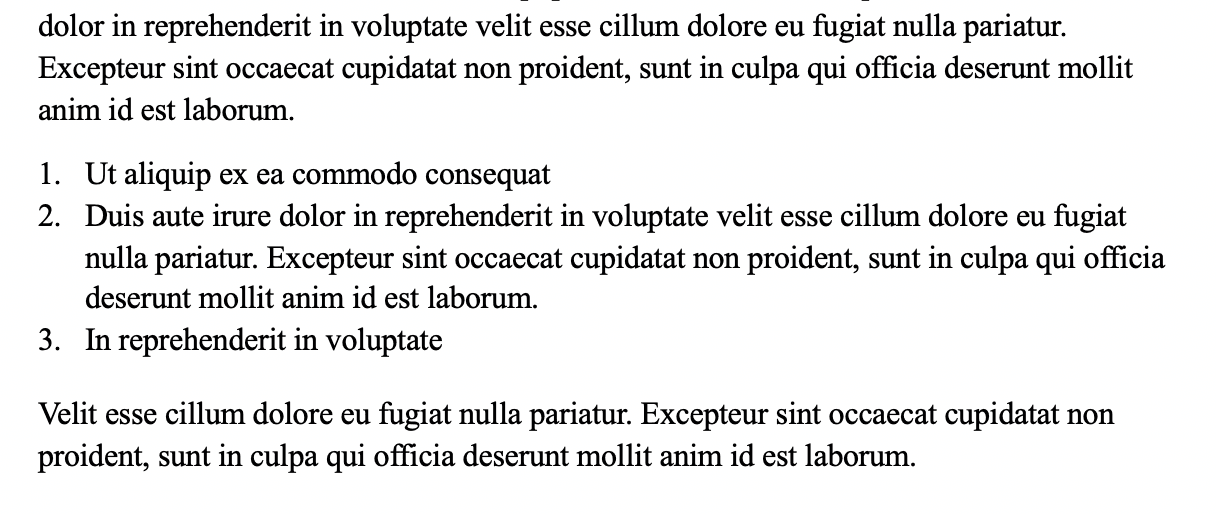

I'd like to format lists, block quotations, and various other things such that there's no space between the list items (or between paragraphs in a block quotation), but there is a space between the list (or block) and the paragraphs before and after.
So far I have two solutions, but they both seem like bad hacks:
  • add an explicit blank line before and after the list or quotation
    create an extra style, in addition to the list or quotation style, that has spacing before, and apply that style to the first paragraph in the list, and likewise create another that has spacing after, and apply that to the last item in the list

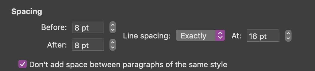

In MS Word, there's an option "don't add space between paragraphs of same style", which allows you to configure say your blockquote style with "space before: 12pt" and "space after: 12pt"", but have it only apply when the previous (or following) paragraph is not part of the quote. But Nisus Writer Pro doesn't seem to have that option.
What's the most Nisus-like way of achieving this kind of formatting?

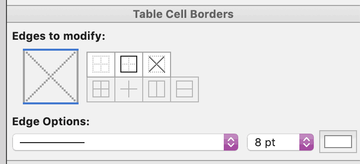

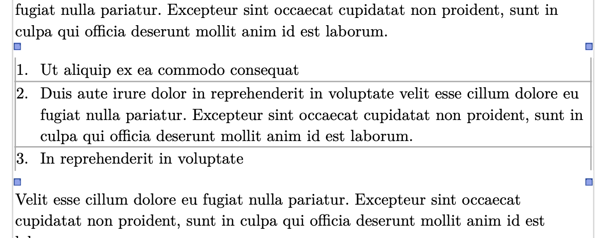

Thanks for trying. I came up with another hack: if you don't need more than 8 points of space before or after, you can fake it with a white table border.

G'day, chronodm et al
Full marks for creativity!
However, as I think has been discussed in another thread, Tables become problematic when they straddle page breaks (virtual or otherwise). In the case of a single-row Table — which is what is required for simplicity in the present context — the entire Table (and its contained list) must fit on a single page. Long lists — or even short ones with large font sizes — can cause difficulties. As well, any number of things could end up pushing the Table down to another page, potentially leaving unsightly white space in its wake.
Another possibility would be to insert invisible Shapes of some sort above and below the list, but I mention this only to dismiss it as impractical.
