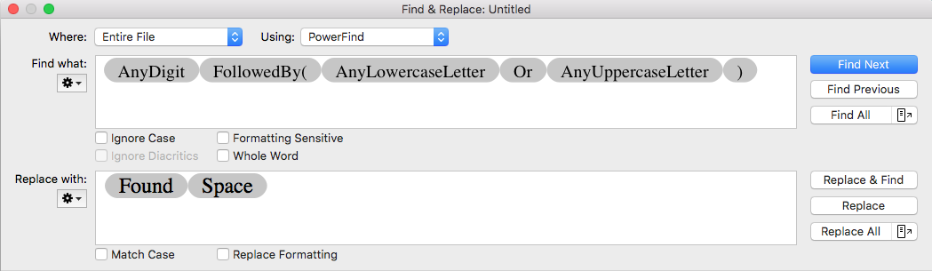

I have a scriptural text that starts each verse with a number, followed by no space (e.g. "1And"). I want to add a space after the number ("1 And").
It's easy enough to Find 1 and Replace it with 1-space. But this becomes a problem once we get to numbers 10-19 (which would turn into "1 9And"),
I want to add a space after any numeral that's followed by a letter. Any ideas? This applies to all 10 possible numbers (0-9).
Thanks.

by seraphim
Thank you for this very helpful information. This worked fine.

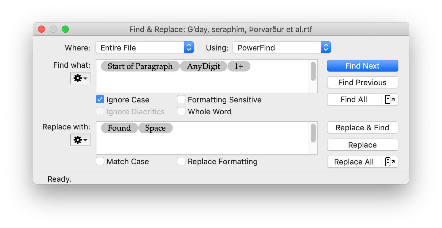

G’day, seraphim, Þorvarður et al
When performing Replace operations on multiple instances of an expression, it is crucial to know your document well, lest you end up replacing things inadvertently.
In the present case, for example, Þorvarður’s solution will insert unwanted spaces in expressions such as “25th” (whether or not the ordinal suffix is superscripted) or “Figure 21C”. Mathematical expressions and chemical formulae would also be vulnerable, but I suspect that would not be a problem here. So it depends on whether your document contains things like this that will also be scooped up by the Find operation.
Another possibility here is as follows:–
Space after leading numbers.png (293.68 KiB) Viewed 15685 times
This one assumes that each verse number occurs at the beginning of a paragraph and that all occurrences of numbers at the beginning of paragraphs are of this verse number variety. Again, it is important to be aware of the contents of your document.
Given that there are 50-odd files to be modified here, note that the Find & Replace window allows you to operate on All Open Files. You probably don’t want to open all files at once, so you might open them in batches of ten, say. In line with the foregoing, be very careful that only the files you intend to modify in this way are open at the time you perform the operation. It should be possible to get a macro to modify all the files at once without opening the lot. Another approach when attacking a large slew of documents, possibly located in nested folders, is to use BBEdit.
