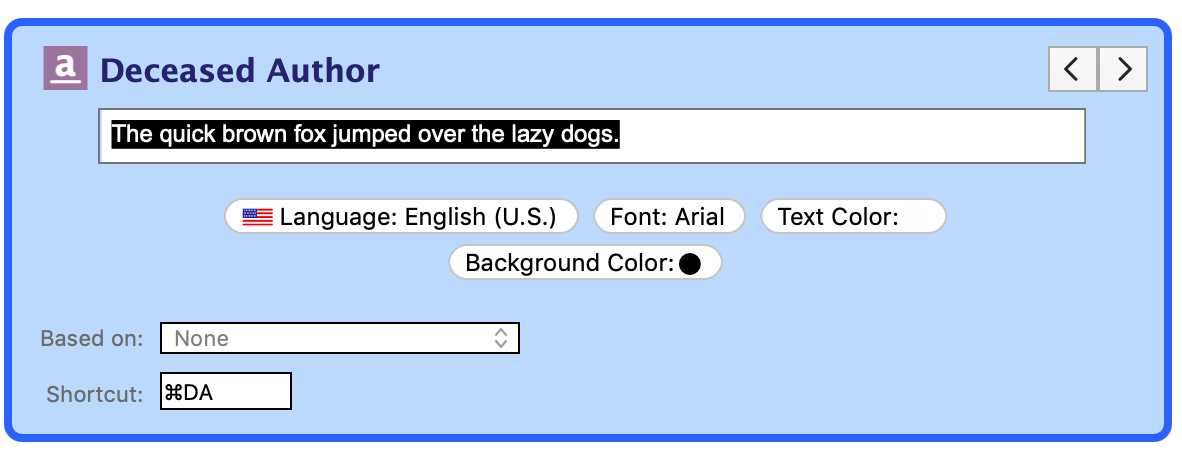

Instead of a black box, could you consider using a black fill? That is, white text on a black background. You could easily create a character style to enforce such formatting.

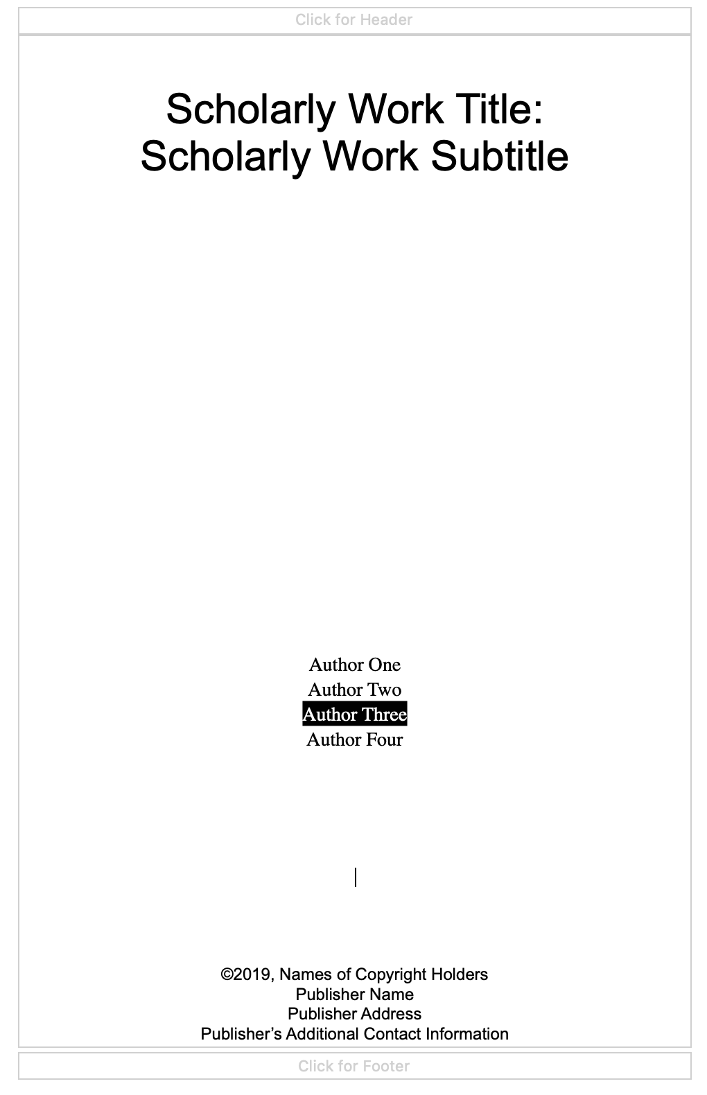

I noticed that the OP is writing from Russia. In Russia and at least some of the countries influenced heavily by its culture, it is common to put a black box around the name of a deceased person (in some cases). I don't know that I've seen it in footnotes, but especially when there were co-authors of a book and one of them died before publication (or before publishing an updated version), then that person's name will be surrounded by a black box. As with many traditions, this one is probably a hard one to modify due to modern desktop publishing limitations. Of all the above suggestions, the only one that seems remotely likely to be understood and (possibly) acceptable would be the black background one. However, I cannot know how publishers and other stakeholders in those cultures would respond to this innovation. Here's what it would look like (using "Character Styles"), assuming "Author Three" died before typesetting the book:
