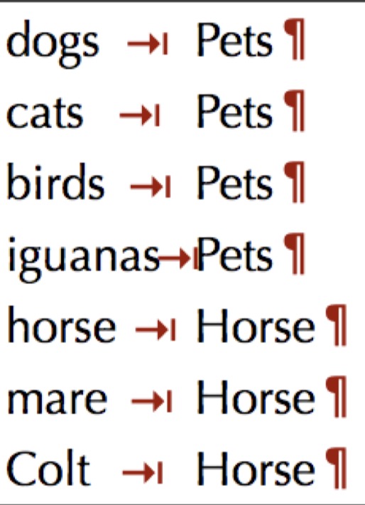

walt wrote: ↑2019-04-13 18:51:46 [...]From the reading I did prior to beginning the task, there was mention of the columns separated by a tab. So I generated a tabbed two column list.
A word list in “tab delimited” form should also work.
word list in “tab delimited” form.jpg (69.26 KiB) Viewed 27423 times

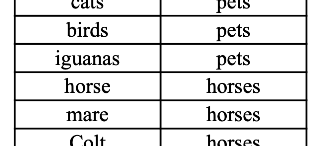

My reply here mostly just echos what others have said, but the command Index Using Word List expects a separate file that contains the word list. This word list file should hold only the list and no other content. You have two options as to the word list file:
1. Any regular text file (RTF or plain text) that has one pair of indexing terms per line. There should be a tab character between the words in each pair, just as Hamid's screenshot above shows.
2. A word list file holding a single structured table (ie: inside a Nisus Writer RTF document). This should be a table with exactly 2 columns. Each row holds a single pair of indexing terms. To mirror Hamid's example:
