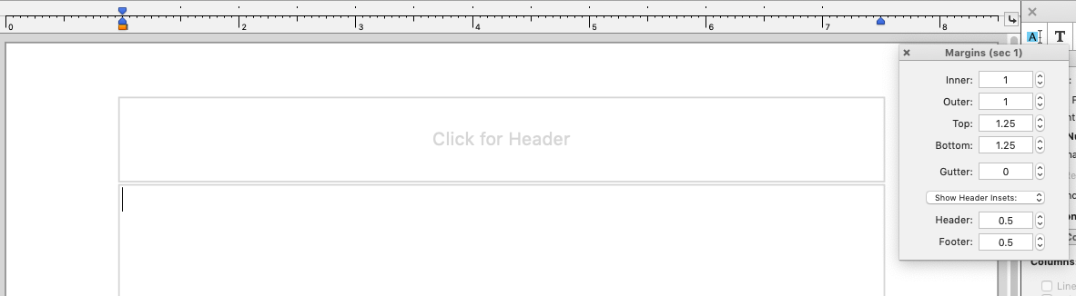

For example, here's a screenshot of the default New File template's header:
You can see the default is to inset the header 0.5 inches from the top of the page, which is what you wanted correct? If I adjust the insets (for example set the top inset to 2 inches and the header inset to 1 inch), save the file, and reopen it, everything appears exactly as I left it.

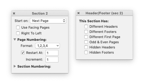

It sounds like your document has multiple sections. Each section is allowed to have its own custom header, footer, margins, etc. That includes restarting numbering as well. To control whether section headers and numbering reset for a particular section you will want to adjust the options in the Section and Header/Footer palettes:
Remember: each section has its own settings, so you'll need to adjust each section in your document.
