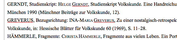

HELP!
Hi, my problem is, any of the proposed find/replace operations just FORMAT the searched for sign (e.g. first letter) ti DISPLAY AS upper case. But if I want to do any further formatting, the letter will switch back to its original format.
Here is the problem:
I want to replace person names typed in upper case into small caps, but as all signs are typed in the same case, changing them to small caps will result in displaying everything in upper case again. So, I first changed everything to lower case and then to small caps. But now, the first letters are not capitalized, which doesn't look good in person names!
So, I tried replacing first signs in words with DISPLAY in UPPER CASE. That worked, but, as I said, if I want to do any changes to the formats, the first letters will switch back to lower case and all effort is lost!
Does anyone have a solution to this? Or is it like that the way signs were typed cannot be changed automatically, but only their format?

Note that Display as Small Caps command does not change characters but just change the way they are shown. In other words, “Firstname Familyname” remains “Firstname Familyname”.
Hi and thank you ... what you note is exactly the problem: I have several texts with hundreds of names in the format "FIRSTNAME FAMILYNAME" and I want to transform them into "Firstname Familyname" and then make them small caps. But this seems to be impossible unless I do it all by hand.
A workaround seems to be to use the placeholder an position commands in find/replace and replace the first letters with caps. But this can easily backfire as soon as I reformat the text (see original post).
Any suggestions out there?

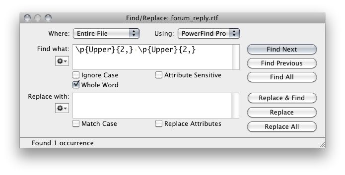

Re: Capitalization
Posted: 2010-05-27 07:34:01
by Kino
wlafi wrote:I have several texts with hundreds of names in the format "FIRSTNAME FAMILYNAME" and I want to transform them into "Firstname Familyname" and then make them small caps. But this seems to be impossible unless I do it all by hand.
How about this?
1. Open the Find panel;
2. Set Using: to PowerFind Pro;
3. Check Whole Word;
4. Type \p{Upper}{3,} \p{Upper}{3,} in the find field and hit Find All to select “FIRSTNAME FAMILYNAME”s;
5. Click on the toolbar of the document window to make it active;
6. Apply Edit:Convert:To Capitalized;
7. Apply Format:Character Case:Display as Small Caps.
I tend to think there is no first or family name shorter than 3 letters. But, if my assumption is wrong, try \p{Upper}{2,} \p{Upper}{3,} or something alike.
Re: Capitalization
Posted: 2010-05-27 08:12:27
by wlafi
Thank you very much for the code!
It worked partly, and it works even if I reformat. But all the FAMILYNAMEs in first position were not reformatted. And in footnotes, none.
Result:

Re: Capitalization
Posted: 2010-05-27 09:17:46
by Kino
wlafi wrote:But all the FAMILYNAMEs in first position were not reformatted.
Because you did not show any example. You cannot expect other’s infinit imagination ;-) Anyway, your screen shot shows that [1] some names do not have first name, e.g. “GREVERUS”, [2] some first or family names consist of two names separated by a hyphen, e.g. “Ina-Maria Greverus” and [3] the format of some names is not “FIRSTNAME FAMILYNAME” but “FAMILYNAME, FIRSTNAME”.
Try “(?<n>\p{Upper}{3,}(?:-\p{Upper}{3,})?)(?:,? \g<n>)*” as the find expression.
