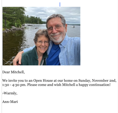

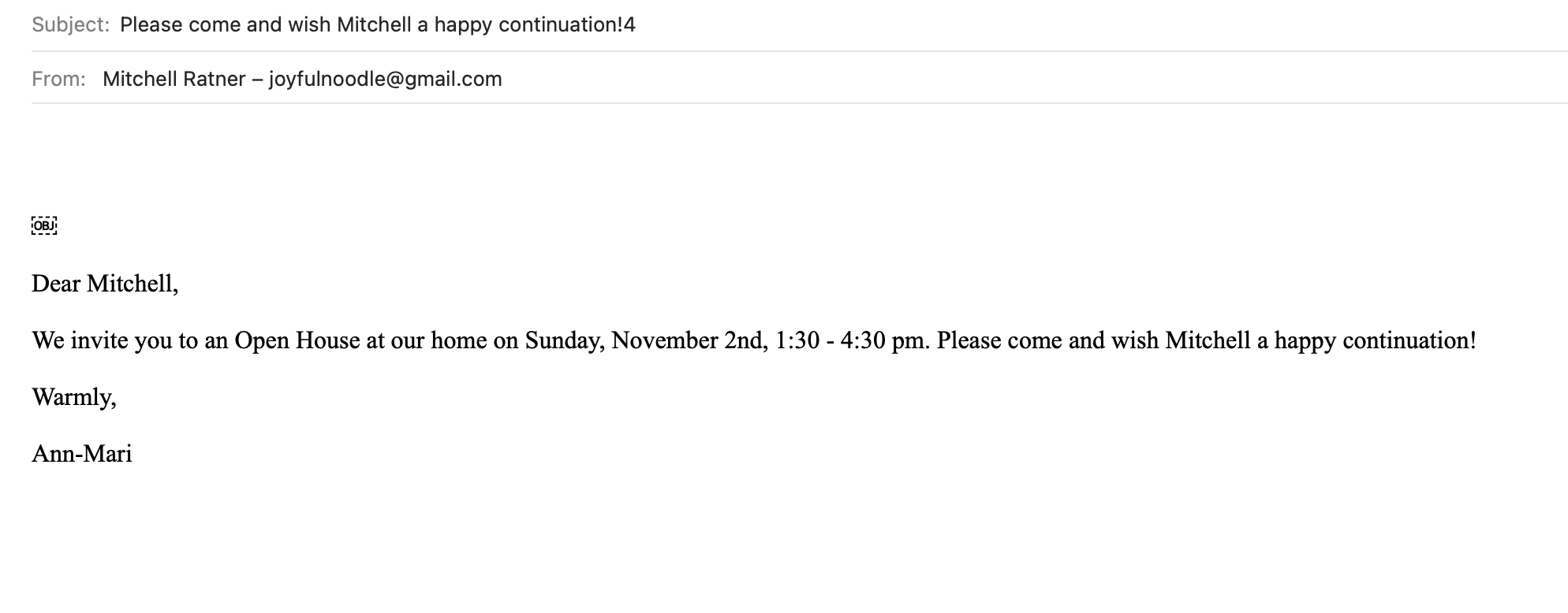

Two Screen Shots attached. The one with the photo s what the document looks like in Nisus and with the Output set to Save Many Files. The other one is what it looks like when the Output is Compose Email. The photo size is 420 Kb. I've tried it with a smaller sized photo and the results are the same.

Thanks for those, Mitchell. I'm probably not going to be able to help you much more with this, given that you're running Sequoia and I'm on Ventura.
But I observe that copying the contents of the NWP document and simply pasting them into the body of a Mail message preserves the image in its proper position, whereas using Mail's Paste and Match Style command results in a pair of parentheses where the image should be (and where the OBJ box occurs on your computer). I interpret this as meaning that NWP's Compose Email command uses the latter Paste mechanism.
Ideally, Nisus would amend the behavior, but I wouldn't hold my breath on that score. One of our Macro gurus may be able to provide a workaround. Or maybe an AppleScript solution is called for. If I were to pursue this last approach, I'd be looking more closely at that OBJ box. I'd double-click on it and see what happened, and I'd Control-click on it and see what appeared in any drop-down menu that materialized.

The text formatting behavior you observe confirms my suspicion that NWP's merge operation uses Mail's Paste and Match Style command.
I have looked at this problem from many different angles and can find no simple solution. In the end, I think AppleScript is required.
I would use NWP to do the merging with the "Save many files" Output option. After all, this is the core task in merging documents and NWP provides the tools for this. I would then use AppleScript to create each Mail message. The script would use the list of recipient details to fill in the header fields appropriately. It would then copy the contents of the relevant NWP document produced by the merge operation and paste them into the Mail message. You only need a single AppleScript script to process the whole lot in one fell swoop.
