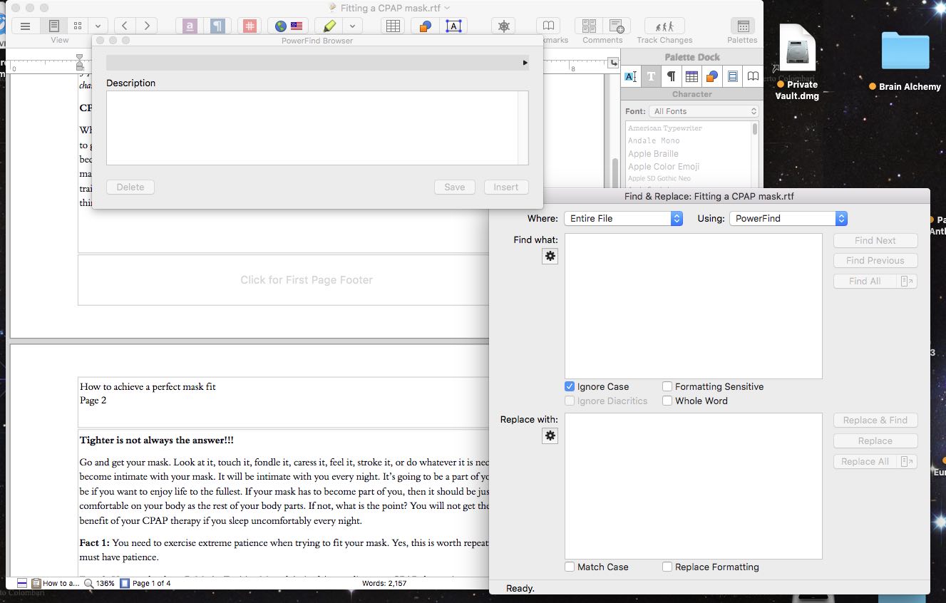

On Nisus Writer 3.2.1, I cannot get the Powerfind Browser to show anything. The window is blank. All the controls are grayed out. I attempted to download another copy of the software but when I tried to install the package I got a dialog box that reads: "NisusWriterPro-v321.pkg can't be installed because its digital signature is invalid."
The software runs beautifully otherwise.
I am running Mac OS 10.11.6 on an early 2008 Mac Pro 3,1.
A screen shot is attached.
Any help appreciated.
Screen Shot 2021-07-06 at 11.55.19.jpg (125.4 KiB) Viewed 25830 times

This is a problem with the PowerFind browser on older system versions like Mac OS X 10.11. I'm sorry, but we won't be able to work around the issue, which is ultimately caused by Apple's developer's tools. At this point 10.11 is a very old system (in Apple terms).
Your options are:
1. Upgrade your Mac to a newer system version. I realize that's not always convenient or possible.
2. Download an older version of Nisus Writer Pro from our version archives. I don't know exactly when the problem was introduced, so I can't say which versions you should try first.
3. Accept the non-functional PowerFind browser and continue using the latest version of Nisus Writer.
I'm sorry for the trouble! I hope that helps. Please let us know if you have any other questions.

For me it seems to just work fine –
High Sierra 10.13.6 on Early 11 Macbook Pro…

I have an early 15 MacBook Pro running Sierra and the latest Nisus; Powerfind works there. Sierra is 10.12, so I think whatever Apple did happened around then.

It takes a bit of courage to comment on an old thread, but I am experiencing this problem here with Nisus Writer Pro 3.4 and 10.14 Mojave.

To make the information more accurate, I tested the older versions one by one and found that in my case, reverting to 3.1 restored the original functionality of the Powerfind Browser. Just FYI
