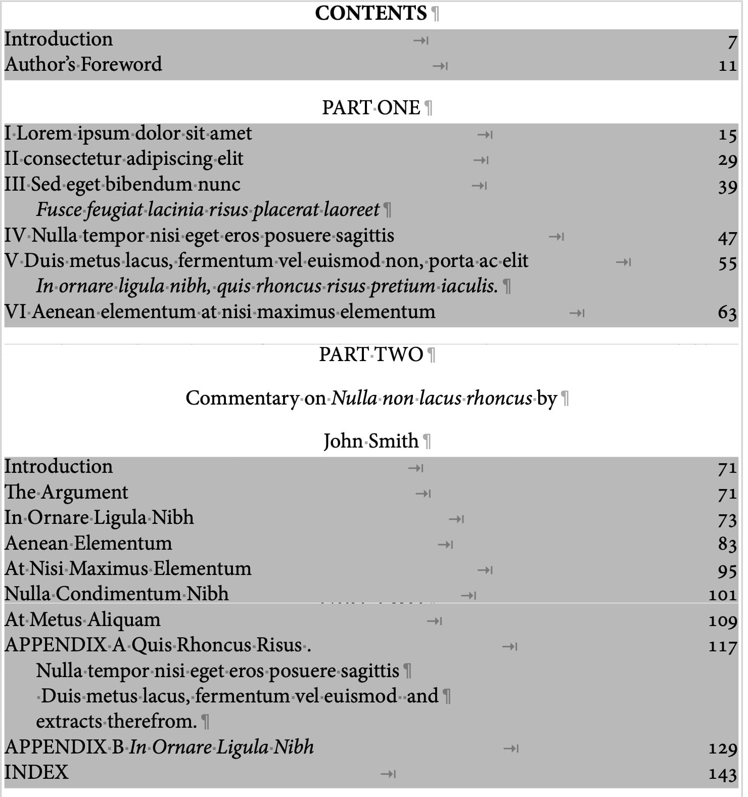

At that time I made three different TOC styles inserted on the same contents page. Here is an example (redacted):Allow the possibility to have a level in TOC where page numbers do not appear for an entry, while at the same time, page numbers appear for remaining levels of entries.
- TOC w & wo p.jpg (151.64 KiB) Viewed 15785 times

This is partially possible, using a single TOC style. If you use the menu Tools > Table of Contents > Configure TOC Styles you can choose whether each level of a single TOC style includes leader tabs. Whether or not page numbers are inserted is currently controlled for the entire TOC, not on a per-level basis.
