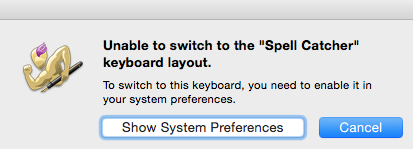

I had to enter my license as well, Yosemite, 10.10.2
Also, I continue to have the problem with the warning (see attachment). No matter I do in the System Preferences or in Nisus Preferences I get the same warning. No other program has this problem. I use Mellel and Scrivener (as well as occasionally Word and OpenOffice) and never once has this warning appeared.
In another post on 2.1 there was a link on how to change the language in System Preferences, yet when I try that, the dropdown is greyed out and so not available to change anything. I type in English, as well as Greek and Hebrew.

I'm sorry for the inconvenience, your license key should have been automatically migrated. It's been determined this was a problem affecting some license keys, specifically those entered using the "Computer" scope option, instead of the "Personal" scope option.exegete77 wrote:I had to enter my license as well, Yosemite, 10.10.2
This error is most likely occurring because one of your languages in NWP is configured to switch to Spell Catcher's input method / keyboard layout. You will want to:Also, I continue to have the problem with the warning (see attachment). No matter I do in the System Preferences or in Nisus Preferences I get the same warning. No other program has this problem. I use Mellel and Scrivener (as well as occasionally Word and OpenOffice) and never once has this warning appeared.
1. Open NWP's preferences.
2. Switch to the "Languages" pane.
3. From the list of languages on the left, select one of the languages in which you work, eg: English, Greek, etc.
4. From the language settings on the right, make sure the "Keyboard" option is not set to Spell Catcher. You may also want to change the setting if it is configured to "switch to last used keyboard". It could be that Spell Catcher was recorded at some point, and NWP is trying to revert back to that for you.
5. Repeat steps 3-4 for all languages you use in NWP.
I hope that's clear. Please let me know if you still have troubles.
Re: Nisus 2.1 asked me to enter my licence like a new user
Thanks. Step 4 was the key. But not quite as you wrote. I had it set to Spell Catcher, and when I changed it to Spell Catcher Unicode. Everything works perfectly.martin wrote: This error is most likely occurring because one of your languages in NWP is configured to switch to Spell Catcher's input method / keyboard layout. You will want to:
