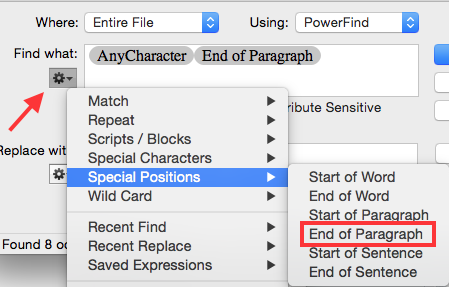

When you say "end of each line", I assume you mean end of paragraph. If that's correct, then you could simply search for the last character of each paragraph, leave the "Replace with" box empty and then click on Replace All.

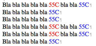

If you enter "C" instead of AnyCharacter, then obviously only the character "C" will be found and replaced at this position. The 55C in red color will not be affected.
Your solution should also work if you remember to include the "End of Paragraph" bubble, at least it worked by me without any problem. :-)

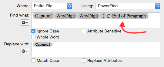

Capture(AnyDigit AnyDigit) C
replace with
Captured1
Did you leave a space before "C"? Maybe that was the mistake.

The PrecededBy worked very fast even on 32MB of text, using end of paragraph at the end of the find helped but didn't set any records. Thanks!
