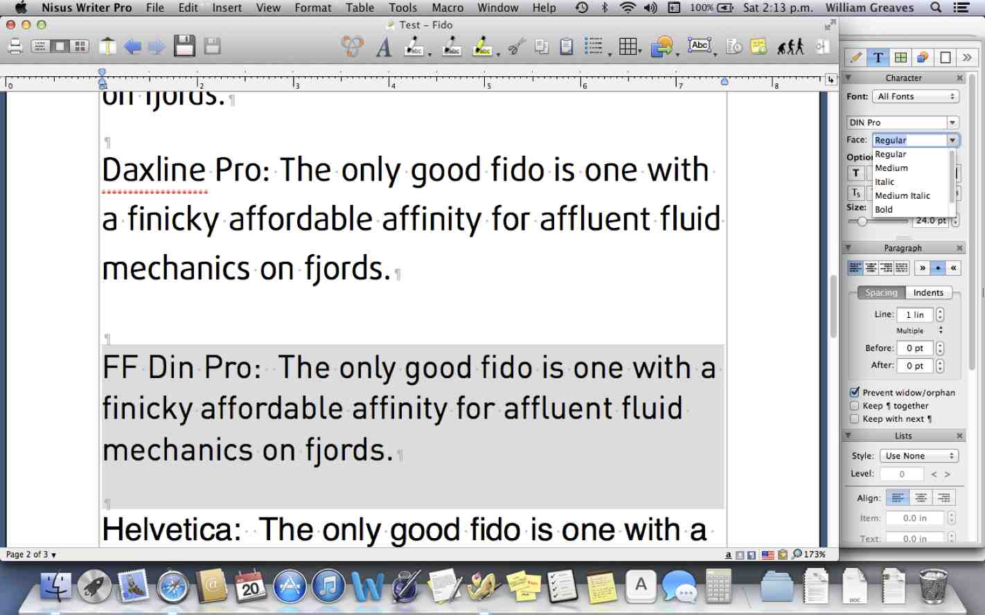

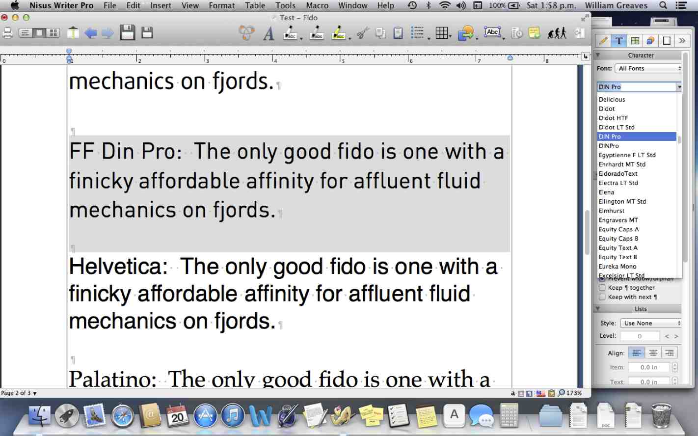

SS6 shows that there are two Din typefaces displayed in the character palette: Din Pro and DinPro
SS7 and SS8 show that each of those typefaces shows only a Regular font.
SS7 and SS8 also show that the text I typed as Din Regular is now displayed graphically as Times.

- DinPro in NWP
- SS3 - DinPro in NWP.jpg (92.56 KiB) Viewed 27937 times
- Din Pro in NWP
- SS2 - Din Pro in NWP.jpg (92.11 KiB) Viewed 27937 times
- Din Pro and DinPro in NWP
- SS1 - Din Pro and DinPro in NWP.jpg (92.68 KiB) Viewed 27937 times
