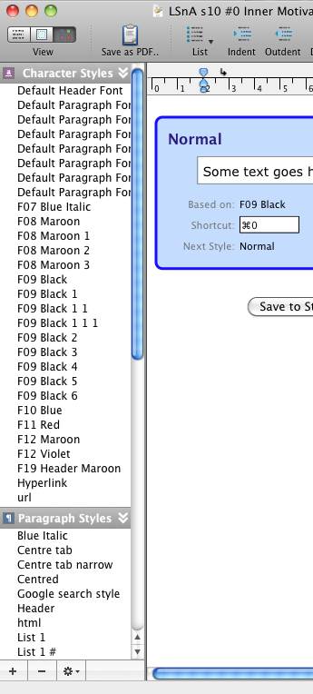

NWP 2.0.4 continues to unnecessarily replicate both Character and Paragraph Styles, even when they're a duplicate of existing ones. :(
I've reported this problem previously, but such unnecessary proliferation is causing problems. I can't even see all my Styles because of the number of duplicates. There are so many copies of F09 Black, that it seems an extra one is being created each and every time I paste anything from another document! see png attached.
So many duplicates you can't see the wood for the trees
NWP bug - Proliferation of Styles.png (62.11 KiB) Viewed 16120 times
So this is to politely but urgently request that this problem be resolved in the upcoming release...

I believe I've narrowed down the cause of this unwanted style duplication, and have identified the circumstances to Martin, who now has it on his list to resolve.
But it seems totally different to yours, Henry...
Thanks

CrisB wrote:I believe I've narrowed down the cause of this unwanted style duplication, and have identified the circumstances to Martin, who now has it on his list to resolve.
Cris did identify a style duplication bug, which we are thankful for, and have filed to be fixed. It is however a little esoteric and involves undo/redo of pasted content with different styles in the Find & Replace dialog. It's unlikely to be a factor here.
There are numerous ways styles might be added to a document, and hence duplicated unnecessarily.

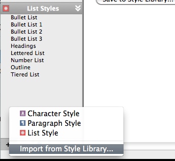

I see that prompt when pasting text with conflicting styles, and it works OK. Only I expect the same behavior when I import styles via the style sheet.
Style sheet.jpg (37.02 KiB) Viewed 16028 times
Henry.

Groucho wrote:I see that prompt when pasting text with conflicting styles, and it works OK. Only I expect the same behavior when I import styles via the style sheet.
Hrm, I just tested and importing from the style library also works correctly.
For example, let's say I add a "Heading 1" style that's based on "Normal", but these styles have different attributes than those in the destination document. I'm prompted about the conflict and choose "Rename Pasted". As expected, a "Normal 1" is created. If I then repeat the addition of either "Heading 1" again (or another style based on "Normal"), then NWP uses the already generated "Normal 1".
Perhaps you can share your test document or exact process that produces too many styles?
