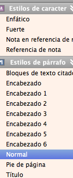

Dunno how it is called in Spanish but switch to Style Sheet view, select Normal 1 (everything in your document is in this paragraph style) and uncheck Format:Paragraph Layout Options:Disallow Widows & Orphans. If you use always Normal 1, I think you’d better correct it in Nisus New File.dot (Preferences => New File => Advanced and Edit Nisus New File...).

OK let's see…, great, seems to work, thank you very, very much!
