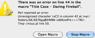

However, when I run the macro, NWP produces the following error msg:
Screen shot 2011-09-30 at 3.52.54 PM.png (35.26 KiB) Viewed 54461 times
When I click Open Macro in the error msg, the following line of the macro is highlighted:
\b (_*) (?:

Ah yes. That character \xC2 is a non-breaking space, introduced by the forum when you copy-paste code from the web. Perl doesn't like it. You can fix it by replacing all non-breaking spaces in the macro with regular spaces. Or download the macro I'll attach here.

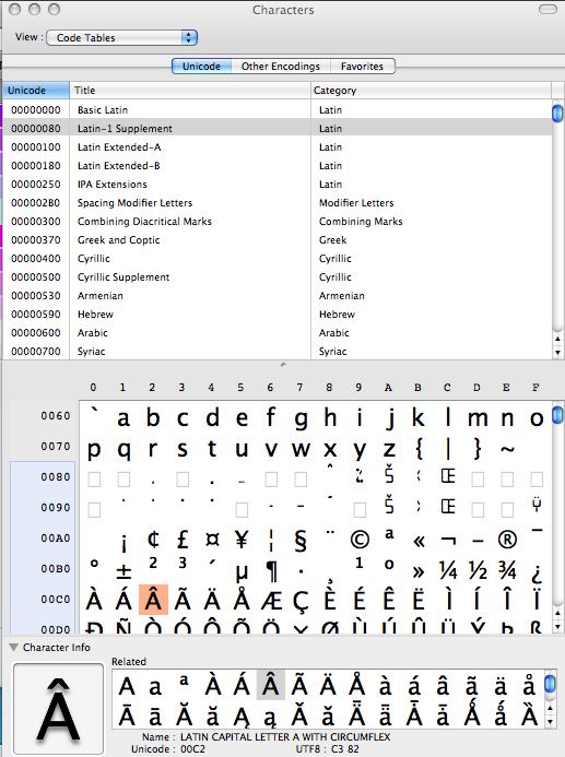

Another question: How could I have figured out that \xC2 means non-breaking space?
I typed c2 or C2 or \xC2 in a NWP document, selected it, and attempted to use the menu command Edit > Convert > From Unicode Code Points, but the command was grayed out. I cannot figure out how to make this command active.
I also tried using the OS X Character Viewer to view the Unicode Code Table. I must be interpreting this incorrectly, because Unicode 00C2 appears to be "capital A with circumflex".

Actually, you're correct Bob, U+00C2 is a capital A with circumflex. I didn't actually look up the character/code, I just knew Perl doesn't like non-breaking spaces and assumed the \xC2 mentioned in Perl's error message was the code for a non-breaking space.
Perl's error message should probably be clarified. When it says "unrecognized character", it really means unrecognized byte in the UTF-8 steam/data. A non-breaking space must be encoded in UTF-8 using a two byte sequence: 0xC2 0xA0. Perl's error only reports that leading byte, even though it's only the first half of the proper Unicode character. It may be that Perl doesn't really deal with full Unicode characters outside of string literals/data, even when declaring "use utf8;"
