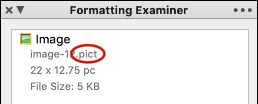

To check if your image display problems are due to the old PICT image format you will want to check the type of image in your document. One way to do that is to use the Formatting Examiner palette. Select the image in your document and look at the file name in the palette:

Using either technique, if you see ".pict" after the file name then your image is a PICT that will need to be replaced.
