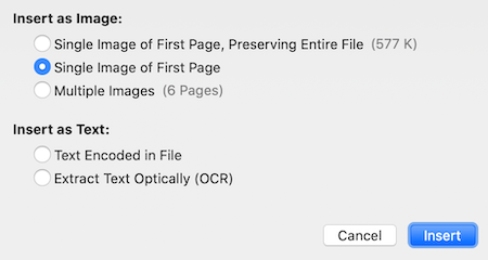

Re: PDF Opens One Page Only
Posted: 2020-11-17 13:22:12
Nisus Writer Pro version 3.2 adds a feature that makes this PDF insertion process easier. If you use the menu Insert > Image > Insert Image to insert a PDF into your document, you will be asked how you would like to proceed. Nisus Writer will offer you the following choices:
You can see that you can insert the PDF as images or text. The latter can either load the text encoded in the PDF, or use optical character recognition (OCR) to scan the image for text. The OCR process relies upon macOS, so Catalina or later is required. The quality of the OCR scan will vary depending on your document and system version.
For more details please see the section Import a PDF from the user guide.
