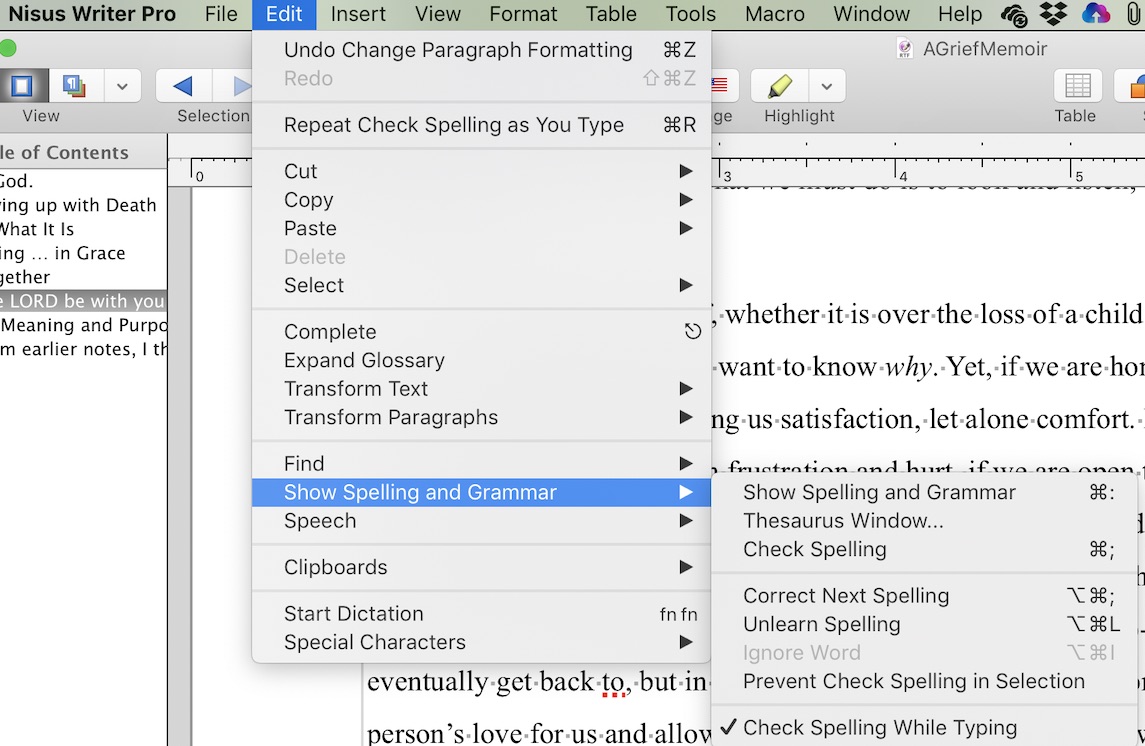

Right there in the app, under the edit menu.
Screen Shot 2018-11-05 at 6.01.24 PM.jpg (200.51 KiB) Viewed 28626 times

UPDATE: When I closed all open files, then quit NWP 3 and reopened it, the menu references to grammar disappeared.
