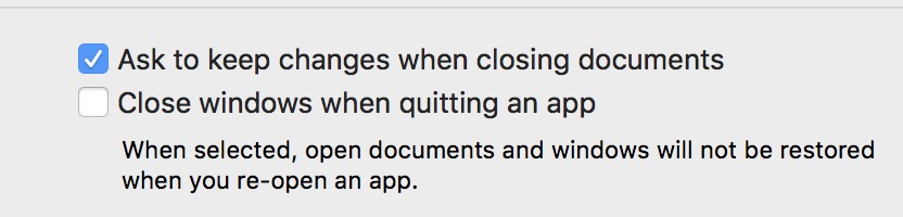

In any case, unsaved changes will be saved, but if you want to see a warning message for any unsaved changes, check the box in System Preferences:General

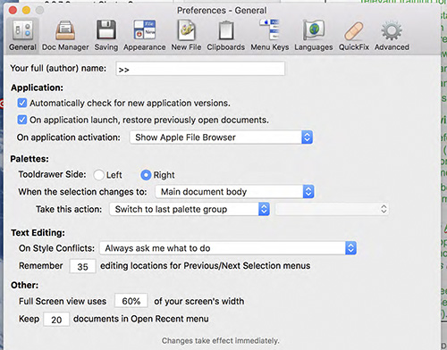

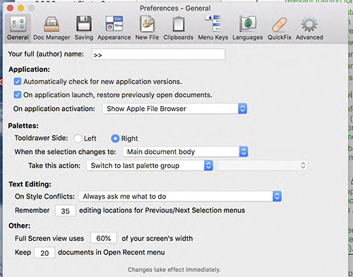

Hi, that looks like a workable solution but when I go to system preferences general I do not see the options you show (I'm using version 2.1.8).
I made a screen shot PDF and reduced its file size in Acrobat to 126KB but when I try to upload it I get a message that the file size is too large.

Posted: 2018-05-14 17:58:59
by MichaelGli
OK, took the pdf to Photoshop and made it a web jpg, bit of a tedious process to get a screen image.

In *System Preferences*, tab to General. There you will find the "Ask to keep changes when closing documnets" setting.

Posted: 2018-05-15 01:27:50
G’day, Michael et al
In case there’s any confusion: You’re looking at Nisus Writer Preferences, Michael, whereas Hamid is talking about the main System Preferences under the Apple logo at the top left of your screen.

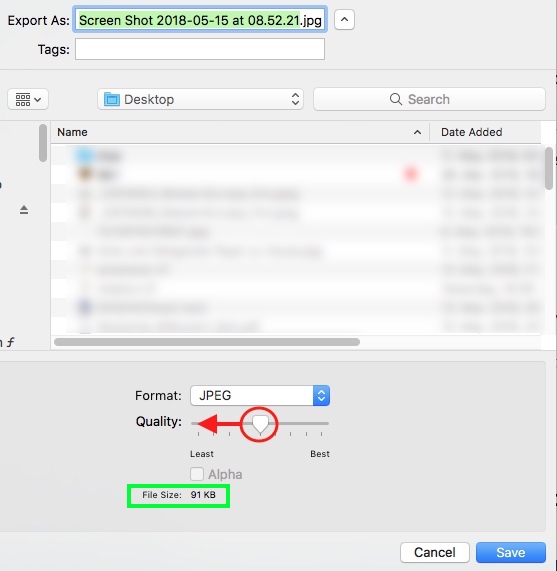

MichaelGli wrote: 2018-05-14 17:56:14took the pdf [Do you mean 'png'?] to Photoshop and made it a web jpg, bit of a tedious process to get a screen image.
Maybe you used a sledgehammer to crack a nut. You can use Preview (the program) to reduce the size of screenshots.
1. Open the screenshot in Preview
2. Choose Export… from the File menu
3. Choose JPEG as Format
4. Drag the quality regulator to the left until you reach your preferred file size
5. Press the Save button
