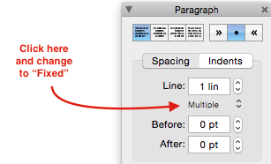

In cases where a change to this particular paragraph attribute is a viable option, Þorvarður mentions that it's possible to tweak this setting in "points". This sounds like a good idea, but I can't see how to do this
Change "Multiple" to "Fixed"
… and lines will change to pt
