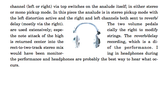

I'm regularly encountering a bug in PDFs made from Nisus Pro in which the image jumps a few lines (changes position relative to the text) in the PDF file.
See two images attached for an example of what happens: my original in Nisus is the one that only intersects two lines of text; the other one is what happened in the PDF; it jumped up several lines.
This time I needed to solve it, and on experimenting I discovered that it only happens if the image is 'Position relative to paragraph'. If I change it to 'position relative to page', it stays correctly in position.
This is only a hack workaround, because I need to change the images in the Nisus file back to 'relative to paragraph' after saving to PDF so they'll stay in the flow of the document when I'm editing.
Other details:
I don't know why some images jump and some don't. My current file has about 20 images; four jumped in this round of saving to PDF (all solved by changing to 'position relative to page'); the others stayed put.

- Screenshot-2-imageJumpsUpinPDF.png (75.75 KiB) Viewed 20262 times
- Screenshot-Nisus-original.png (81.41 KiB) Viewed 20262 times

I'm having trouble with this too, except I'm dealing with 100s of images, not only 20… and found that most of the times, the only way to solve this is to insert the illustration in a table so it stays put!

Yes, this is indeed a known issue that doesn't have a general purpose workaround- sorry about that. But we are aware of this bug and want to get it fixed. Some things can help stabilize the image location, like changing the placement to "fixed on page" as Steven did. But clearly that isn't a viable long-term solution.

I don't use images, but if your Nisus file prints all right, you could save it as a ps file and then open that with Preview. If it doesn't print correctly either, then obviously this won't work.

Interesting idea.glh wrote:I don't use images, but if your Nisus file prints all right, you could save it as a ps file and then open that with Preview. If it doesn't print correctly either, then obviously this won't work.
I tried a parallel test, saving to PDF and exporting to PS, and, annoyingly, the bug didn't occur in the PDF for the first time I can remember. So the fact that it didn't show up in the PS either doesn't say anything yet. Next time it occurs I'll try one in PS.
One additional thought about this test I just did: in each case I closed and re-opened the file before saving PDF/exporting PS (which I don't always do), to make sure it was as 'clean' as possible. Possibly this is related to the bug not showing, because Nisus regularly fouls up the placement of images in the flow and/or forgets the last few lines on a page when I'm editing in a way that changes the line flow, and I sometimes have to re-open the file to get Nisus to show the layout as it actually is now.

I've now had a chance to work this through with a jumping image, and it looked promising -- it solves the jumping image -- but then I discover that the change from PS -> PDF (via Preview, which I need to do because I must end up with a PDF at the end for commercial printing) ends up with corruptions in letter placement. Letters occasionally get printed horizontally shifted overtop of other letters in about 10% of my pages. These only show up when the final PDF is printed from Adobe Reader, and not on screen in any case, but I consider Adobe Reader the gold standard for PDFs so I can't use this method; some sort of corruption is occurring in Preview's translation from PS to PDF (or possibly earlier in the creation of the PS).glh wrote:...you could save it as a ps file and then open that with Preview. If it doesn't print correctly either, then obviously this won't work.
So, I'm still back to trying to get PDFs directly out of Nisus, without having the images jump.
I've sent samples to Nisus feedback; I hope they can find a way around this.
One last discovery is that the Nisus file itself changes after 'saving to PDF': in the original .rtf Nisus file, the image jumps and stays out of position (until Nisus is closed and opened). Thus the jumping is happening, it seems, in Nisus before it is translated into PDF, but it is caused by the action of saving to PDF, somehow.

An update: I have some added steps that allows the suggested ps workaround to function in my case, although awkwardly.stevenrowat wrote:I've now had a chance to work this through with a jumping image, and it looked promising...but [from the ps] ...Letters occasionally get printed horizontally shifted overtop of other letters in about 10% of my pages.glh wrote:...you could save it as a ps file and then open that with Preview. If it doesn't print correctly either, then obviously this won't work.
Summary: Save to both PDF and PS, open both in Preview, and drag good pages from PS to PDF to replace the jumped-image pages there.
This may not work in other cases, but it seems to in mine.
Detailed steps:
1. Save Nisus rtf file to PS.
2. Save Nisus rtf file to PDF.
3. Note which pages are damaged by the 'jump' in the PDF version.
4. Note which pages don't print right from the PS version (when saved again to PDF).
5. As long as there's no overlap (ie, pages in step 3 and step 4 are all different):
6. Replace the bad ('jumped') pages in the PDF file from step #2 with good pages from the PS file in step #1. This can be done easily in Preview, which will open both the PDF and the PS and will allow the pages to be dragged and dropped.
7. Save the repaired PDF file from Preview, and it should correctly reflect the Nisus original and print OK from Adobe Reader.
In my case, there are no overlaps (only 1 image jumped, damaging two pages, and neither of those were ones that had the PS print bug), so I could replace them. If there is overlap, this workaround won't do the job.
