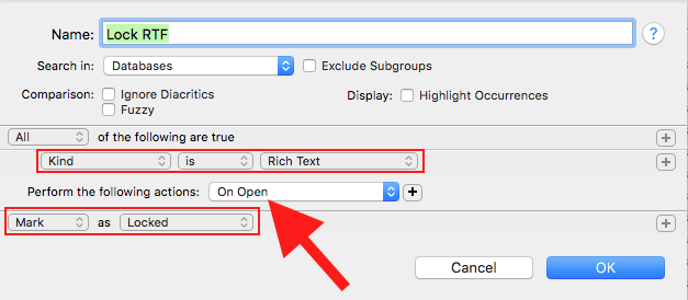

I think it's actually the other way around, DEVONthink, EagleFiler, Together 3 and all the other content managers out there do not support certain advanced components of RTFs, such as footnotes and styles, because their main purpose is to store data, not create data.
To prevent DEVONthink 3 from accidentally destroying footnotes and styles in .rtf files (both in Nisus and MS Word), you can do this. Create a Smart Rule in DEVONthink which marks the file as "locked" so that it will be always automatically opened and edited in Nisus.
The file will remain locked until you unlock it manually, but why should anyone want to do that? There is no reason I can think of to do that. Editing and reading a Nisus document is always best in Nisus Writer itself.
Wow ! an extremely intelligent solution which I will implement. I will make a minor modification, which is to add one action to your rule: to display a notification stating that the doc can only be opened in NisusWriterPro based on a custom smart rule. Just in case I am hospitalzed with covid, come out of a coma in 3 months, forget that I created the rule, and start searching for the reason why RTF files are blocked.
