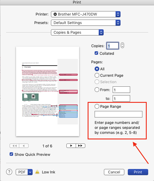

Maybe I'm missing something obvious here but how can I print e.g. pages 1 to 3 plus page 9 and page 12?
Word 2016 print dialog has a dedicated setting for this but the option is not available when printing from NWP3.
Screen Shot 2019-08-23 at 22.48.37.png (89.97 KiB) Viewed 3636 times
The obvious workaround is to create a PDF and then print only selected pages; a time waste especially considering that during long docs preparation such partial printing could be frequent.

I currently use a Brother MFC-J5730DW Printer. I looked at the Print dialog box for documents in several applications: in none of them was there a Page Range option such as that depicted in your screenshot — just "All" and From… to".
So it would appear that that Page Range option is specific to Word (which I don't have).

sorry for not being clear in my post; yes, that option is supplied by Word and it will not be available in NWP unless it is included as a new feature.

Good suggestion, thank you. The print dialog only has the "From" and "To" fields available for user input and both of them only accept a number (no commas or hyphens).
P.S. Reading again your post maybe you interpreted my request as the need to print a range es 12-15. This can be done. What I'm missing is the ability print specific non adjacent pages.

I would be most reluctant to employ a method that used PDF as an invisible intermediary for printing
I think your reluctance to use PDF is misguided. Generating a PDF on macOS is essentially the same as making a printout. For any modern app the process involved uses exactly the same pagination and drawing code. It's just that the data is captured as a PDF file instead of being sent to the printer immediately.
Posts: 311
Re: Print specific pages
Post by adryan » 2019-08-28 14:23:04
G'day, Martin et al
Thanks for another great addition to the macro collection, Martin.
With respect to my distrust of the Mac's PDF system, it's born of long experience — including yet again yesterday, as a matter of fact. I think there are two factors involved. One is that line wrapping appears differently from the original, although this is probably understandable when dealing with Mail and Web browsers. The other is that paper size is set inconsistently in the Print dialog (which is something you never get to check if you use the Export as PDF command, so I tend to avoid it). What seems to happen is that, even if a printer preset configuration specifies a particular paper size, a different paper size can appear specified elsewhere in the labyrinth of the Print dialog. Having said all this, I don't think I've experienced such problems when converting NWP documents to PDF files, so my scepticism is more in the nature of a default position, I guess.
