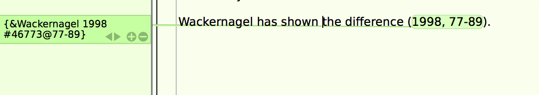

But since I don’t like having all that ‘code’ in my text, I just type what I want in my final text and attach a Comment with the ‘code’ in it, as in the attached screenshot.
It’s not really so ‘dangerous’ to do this, by the way. And don’t think that you’ll lose the flexibility of the citation marker: it’s still there in the Comment and if you want at some point to replace the Marked Text (the in-text text which has a Comment attached to it) with the content of the Comment itself, it’s easy to do. Have a look here for a macro that will do this:

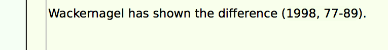

And just in case: you can turn down opacity in Comment Display Options (Tools menu) and hide Comment Pane. This hides all the 'ugly' stuff. See 2nd screenshot.
