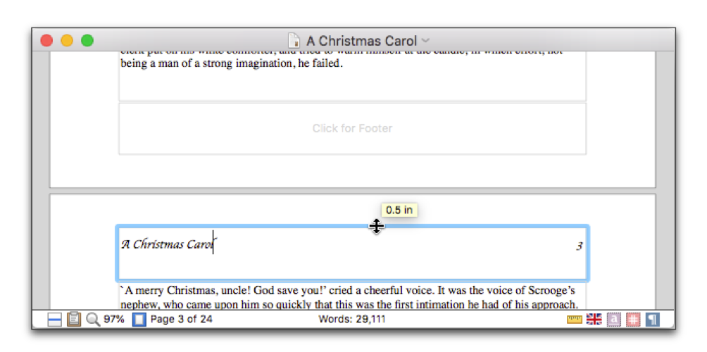

Move a header or footer higher or lower on the page
The headers and footers hug the top and bottom of the document window respectively. You can move headers and footers in relation to their physical position on the page.
1. Click in the header or footer.
2. Drag the top margin line higher or lower on the page.
The pointer changes shape to indicate that it moves the margins and a “help tag” appears indicating the distance from the margin to the edge of the paper.
Figure 161
Moving the outer edge
of the header margin
3. Click back into the document.

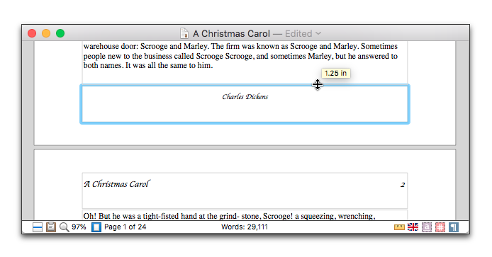

Move a header or footer higher or lower in relation to the text of your document
2. Drag the inside line of the header or footer higher or lower on the page.
Figure 162
Moving the inner edge of the footer margin
