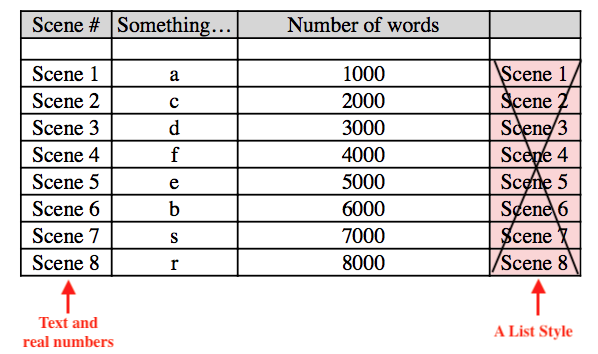

I'm attempting to put a column of automatic numbers in a Table
Let's begin by clarifying the terminology. Automatic Numbers in NWP are here: Insert –> Automatic Number. In your case, however, it seems you are not using automatic numbers, but rather a list style to generate numbers. That's why (the list) numbers always appear sorted ascending.
but perhaps there's a workaround
Yep. Use real numbers instead.
I know I can do this by adding all the Scene # numbers by hand, but that is painful because then if I add or delete one, all the others need to be updated by hand
If you are talking about numbers generated by a list style here, then you only need to select the cells in the scene # column and then choose the list style from Format –> Lists –> Scene # (where "Scene #" is a list style that you created for this purpose.) Or, alternatively, select the style name in the List palette, and your scene # column will be magically updated, all in one go. (See screenshot no. 2)
But as I already said, a better approach is to use real numbers. (See screenshot no. 1)
You don't need to enter the numbers by hand; use a macro to do this automatically.
Here is a macro that does this for you. If you add or delete rows, then just run the macro again and it will update all the numbers.

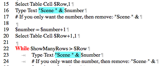

Can this macro be edited to produce numbers in a way that will sort in sequence in the table?
Yes, just remove "Scene " & from the macro.
Turn line numbers on, and you'll find the string on line 16 and 23.
Excellent. This works as you say, and solves my problem.
