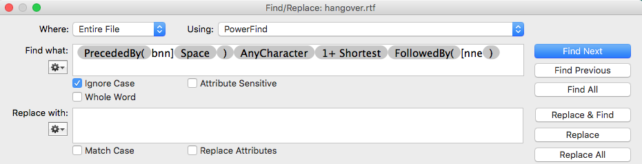

You can carry out "attribute sensitive" searches across all open Nisus documents. There is a macro for that called “Find in All Documents” or “Find in All Open Documents”.
I've started using different paragraph styles to format different types of subject matter, such as nature notes, household events, dreams and so on.
[See: <viewtopic.php?f=18&t=5561&hilit=david+Sharp>]
It seems you are trying to use NWP as a database, which may not be a very good idea. However, it’s hard for us to say for sure, because we don’t know exactly how your document looks like and why you are using paragraph styles to tag different types of subject matter instead of using, for example, inline tags in brackets, which won’t slow down performance. You could, for example, tag your nature notes with [bnn] and [nne] respectively, where “b” stands for “the beginning of a nature note” and “e” for “the end of a nature note”.
Inline tagging would enable you to quickly find all your nature notes; and with Find All plus Copy you could easily extract all these notes and paste them into a separate document for further editing.
The screenshot shows how to search for all nature notes:
[bhe] = beginning household events
[ehe] = household events end
Plus of course, all my date headers (year, month, day) have a different style.
Does that mean that years, months and days all have different styles? How does this work exactly?
