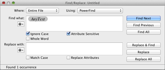

1. Open up NWP's find & replace window.
2. Insert the "AnyText" PowerFind bubble using the little gear icon's popup menu (or some equivalent wildcard).
3. Select the inserted bubble and apply italics (eg: via the menu Format > Font Face > Italic). This should automatically checkmark the "Attribute Sensitive" search option.
4. With the bubble still selected, apply bold once; then apply bold a second time to explicitly turn bold off (this actually adds a "not bold" or "unbold" attribute).
The resulting find window should look something like this:
A little bit more on what happened in step 4: by default the find field has no attributes applied. That means it doesn't care about any attributes, and only characters will be matched without regard to formatting. The first time you apply bold that adds a bold attribute "bold", as expected. The second time you apply bold that switches the bold attribute match to "not bold" or "unbold".

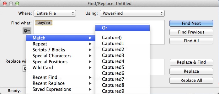

martin wrote:It would be better if the menus gave clearer feedback on what's happening exactly, or allow some other way to more explicitly choose these options
Since Nisus has already an "Or" bubble (see screen shot),
one way could perhaps be to introduce an additional "Not" bubble. The user could then insert and apply italics to the "AnyText" bubble, then insert a "Not" bubble and finally "AnyText" with the attribute italic and bold. That would be very intuitive from the user's point of view, but I don't know if that is possible from the developer's point of view. :-)

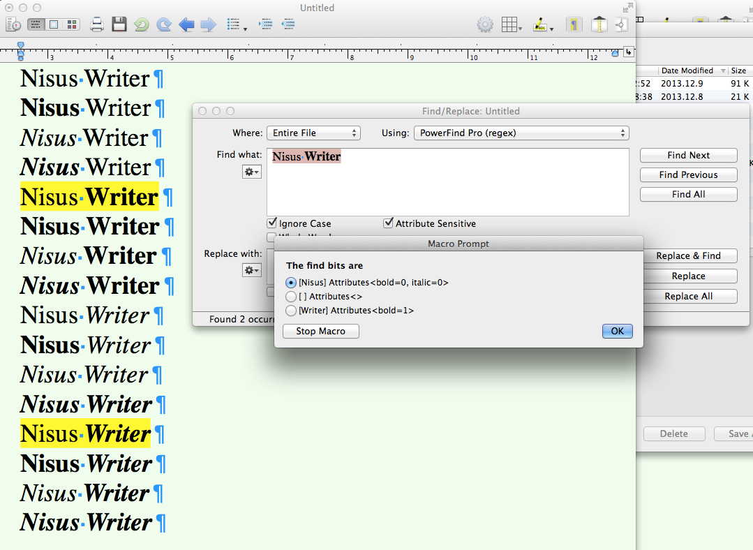

Just to elaborate a bit; I took Martin to be referring to the problem that always bother me about attribute sensitive searching. It's that I often have a hard time telling which attributes are being used/checked by the search. If you start with a 'clean' find dialog and construct the expression you usually have no problems, but if you use "copy to find" and then add or remove attributes, you often find that the search fails and it can sometimes be quite a challenge to figure out that there is some ruler or paragraph style applied that is causing the search to fail.
So I would like it if the find dialog had some visible list of the attributes (with words like 'unbold'). But the problem is that these attributes might be applied to only part of the find expression, and it would be quite a challenge to show how these attributes applied to the text.
But here is my idea: Imagine a button next to the find box that said "inspect attributes" and then, when clicked, would open a window in table form with two columns. The left column would show the bits of text with the same style. The column on the right would show the attributes in 'text' form (like in the style sheet).
Re: How to find italic, but not italic bold
Posted: 2013-12-15 00:13:28
Here is an impression of what I have in mind. Obviously a built in feature would have a better interface that actually allowed setting the attributes.
Note the specification of "bold=0" which means "unbold", etc.
Get Find Box Attributes Macro.jpg (94.73 KiB) Viewed 19038 times
Here is the macro used for this:
Get Find Attributes.nwm
(16.58 KiB) Downloaded 584 times
