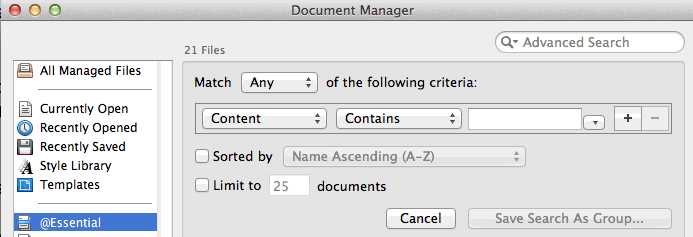

David Sharp wrote:[...]Unless I'm mistaken, NWP doesn't allow users to search through a group of documents.[...]
It is possible to search through a group of documents using the search options in the Document Manager. The range of the group of documents through which search can be done can be as wide or narrow as you like. An easy way to manage a narrow group is to have the group of documents inside one real or smart folder. For example, here in this search, I want to search through a smart folder named "@Essential".
David Sharp wrote: [...]Before I start thinking about diversifying to yet another software program - I feel I already have too many - I'd like to ask a basic question: why doesn't NWP also use this "package" approach? Or does it already, in some way I'm not aware of?[...].
I suggest you explore the wide range of possibilities available in the Document Manager.

In reply to Hamid:
Indeed, I'm taking a closer look at the document manager, having previously, I confess, only skimmed that part of the user manual.
I note however that the search engine available via the document manager is Apple's Spotlight, rather than Nisus's much more powerful search tool.
