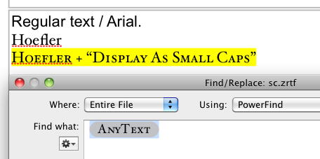

I don't have the HaifaSC font to test with, but I see the problem if I try to use another font with face options. For example, trying to search for all text in the "Hoefler Text" font using the "Ornaments" face fails (one can easily select all text in Hoefler, but not just text in the Ornaments face). Even using the little underlined "a" font tag doesn't seem to limit the search to just the Ornaments face. I'll file a bug or two on this.
I would like to say that this isn't a problem for fonts that expose their small caps through Apple's typographic features, instead of using a separate font face. For example, Hoefler has proper typographic small caps that extend over all its faces. To search for that I can insert an "AnyText" PowerFind bubble, apply Hoefler, and then "Display As Small Caps" (which uses real/typographic small caps when a font makes them available). The results of a Find All:
