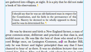

Thanks, Martin, but I meant something a little different. Like in this screenshot:
Screenshot 2011-06-29 at 3.54.42 PM.gif (19.9 KiB) Viewed 6076 times

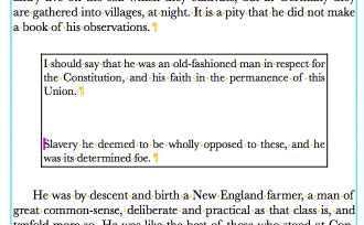

I just set space before and space after (in Paragraph palette) to a convenient amount. All very well with a single paragraph. But with two or more paragraphs, the space applies between paragraphs too. Like this:
Screenshot 2011-06-29 at 4.02.28 PM.gif (14.83 KiB) Viewed 6076 times
Sure I can apply different spacing to first paragraph, last paragraph and those in between. Or apply special space to the paragraphs that come before and after. Feasible. It just takes some doing. That’s all. I just hoped this could be done more easily through the shading formatting.

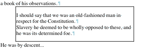

Not the prettiest, but perhaps it would do.
