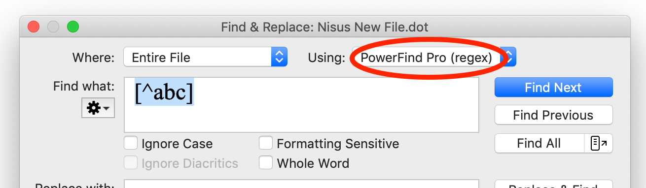

Hi Ray! Nisus Writer can definitely help you with this task. You can use PowerFind Pro (aka: regular expressions / regex) to find all the characters you don't want and replace them with nothing, effectively deleting them. The trick will be in identifying the characters you do want to keep.
The basic idea will be to use a negated character class to find all the characters you don't want. You do that with an expression like this:
The expression in the find field will match all characters that are not inside the brackets (aside from the leading ^ character which does the negation). The expression [^abc] matches all characters except a, b, and c; that expression would find and replace d, e, f, etc.
You want to find all characters that are not ASCII. To do that we'll use a character range inside the negation. The pattern [^a-z] would match all characters that aren't A through Z. But you want to replace all non-ASCII characters, so you can use the pattern [^\x00-\xFF]. However, that might also replace other characters you want to keep, like curly quotes. If you need to preserve additional characters, just add them to the end of the character class. For example, to delete all non-ASCII characters, but preserve curly quotes, you could use this find pattern:
[^\x00-\xFF“”‘’]
I hope that helps! Please let us know if you have any more questions.

raybythelake wrote: 2020-03-06 12:19:40I just want to REMOVE all non-ascii characters. So should I use the [^\x00-\xFF“”‘’] expression in the Regex PowerFind?
That's probably a good place to start. So you want to:
1. Open the Find panel.
2. Set the "Using" popup button to "PowerFind Pro (regex)"
3. Paste the expression [^\x00-\xFF“”‘’] into the "find what" field.
4. Leave the "replace with" field blank.
5. Click the "Replace All" button.
Let us know how it goes, or if the results are not what you wanted.
