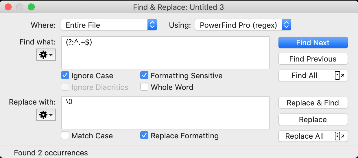

G'day, shmuel et al
One way of doing this is to use the Find & Replace system with settings as in the attached illustration. (The Case checkboxes don't really matter here.)
Changing Paragraph Style.jpg (190.74 KiB) Viewed 24889 times
The expression in the Find field was obtained from the drop-down cogwheel menu ("Find what:") under Wild Card > AnyParagraph. The expression in the Replace field is "backslash zero".
Select the contents of the Find field, then Format > Paragraph Style > Paragraph Style B (or whatever).
Select the contents of the Replace field, then Format > Paragraph Style > Paragraph Style A (or whatever).
Then click on the Replace All button.
When making major changes such as this to an entire document, it's advisable to do it on a duplicate, just in case of mishap.

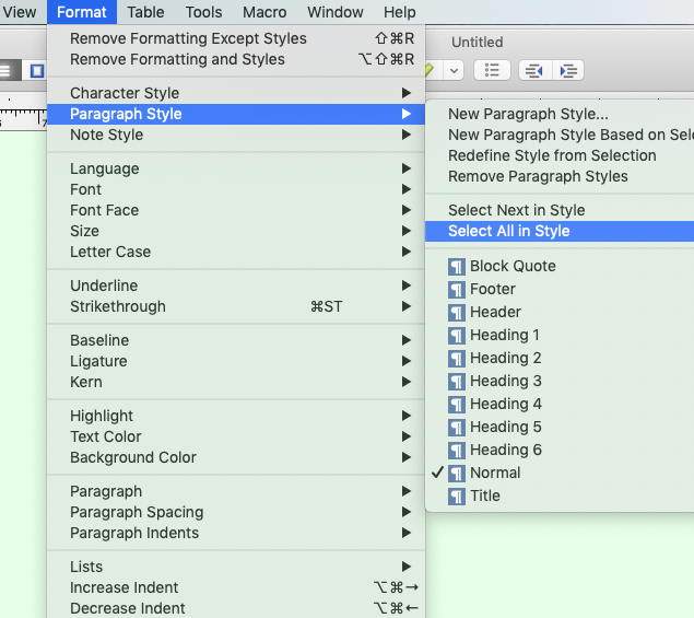

by vwnisus
phspaelti wrote: 2019-10-25 02:40:00 With all respect to Adrian, the more straightforward method is to place your cursor in a paragraph with Paragraph Style B and then:
  1. Choose Paragraph Style:Select All in Style
  2. Apply the desired Paragraph Style A
Find is not really needed for this.
I would to know where I can find "Choose Paragraph Style:Select All in Style" in the menus? I can see there is a "Paragraph Style" in the Format menu but it does not have a "Select All in Style" option.

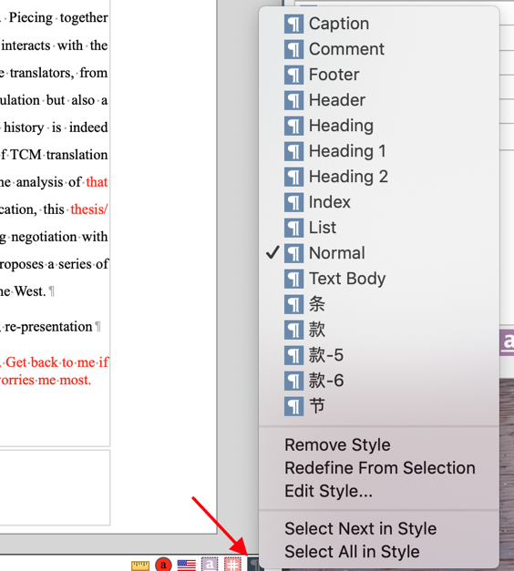

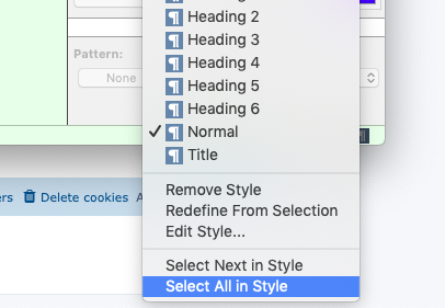

Re: deleting paragraph style B and replacing it with paragraph style A
Posted: 2019-10-26 00:31:42
vwnisus wrote: 2019-10-26 00:04:17 I would to know where I can find "Choose Paragraph Style:Select All in Style" in the menus? I can see there is a "Paragraph Style" in the Format menu but it does not have a "Select All in Style" option.
Really? Mine does.
Also you should be able to find it in the Paragraph Style menu of the Paragraph Style icon in the bottom right corner:
Posted: 2019-10-26 08:26:21
by xiamenese
Two other points might interest you, @shmuel:
1) You can access "All in Style" from the paragraph Icon in the status bar at the bottom …
Screenshot 2019-10-26 17.04.23.png (288.52 KiB) Viewed 24815 times
Posted: 2019-10-26 23:39:27
by vwnisus
Really? Mine does.
Sorry. You are right. For some reason, initially, I could not see it.
