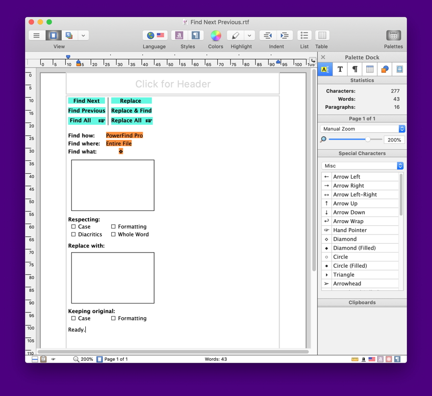

I think it is possible to implement a Find Palette that offers all the required options within the confines of the Palette Dock but without appearing unduly cramped. And here’s proof!
Find Palette.jpg (257.21 KiB) Viewed 11647 times
This is a screenshot of a mockup on a 13-inch MacBook Pro. The window extends to the full height of the screen (apart from the main Menu Bar); the screen extends horizontally beyond the image. The document happens to be A6 size, but this is of little consequence in the present context. The important thing to note is the relative sizes of the Palette Dock and the content of the Find Palette mockup. All the options of the traditional Find/Replace window should fit in the Palette Dock without the need for scrolling within the Palette Dock — and this is on a small screen. Scroll bars that appear automatically in the Find and Replace fields when needed would probably be required.
I haven’t bothered to get the sizing of things exact: it’s just a mockup, after all. But I would go so far as to suggest that it would even be worthwhile extending (marginally) the width of the Palette Dock as a whole if that’s what it took to accommodate a non-cramped Find Palette.
The user could always choose to make the Find Palette a Floating Palette if desired.
In the mockup, I have used different highlight colors to distinguish between buttons and drop-down menus. Icons used are merely indicative.
I have taken the opportunity of suggesting alternative wording in places, as I for one find some of the existing wording confusing.
One technical issue that occurs to me is that the Find and Replace fields would need to be responsive to relevant choices from the main hierarchical menu (for example, when choosing a font). I think this would make the Find Palette unique amongst the Palettes.
Anyone else care to play Seek-and-Hide? Ready!

Thanks for your additional thoughts on this potential enhancement Adrian. One thing that didn't come through: your mockup screenshot does not show. It looks like you added the image as a forum attachment, so I'm not sure where the problem lies. You might try posting it again.

Sorry about the image’s failing to display. It did when I originally posted it.
I have had a lot of difficulty trying to re-post it now. Hard to get it to appear only once, and in the correct position. I tried drag-and-drop, inline button, img tag, URL with and without attachment tag. Original PNG file was rejected as too large, so I converted it to a reduced-size JPG file. No explicit instructions in the Forum FAQ about any of this makes posting images unnecessarily difficult.
Anyway, I’ve edited the posting so at least the image appears there now, albeit twice. You might be able to edit my posting so it appears properly, Martin.
Re: Find/Replace Dialog
Posted: 2019-07-18 15:23:59
Thanks for fixing the image. I think you just missed the "Place Inline" button that appears next to any attachments you upload while creating a post. That inserts the proper phpBB tags, which is the reliable way of showing an attached image inline, instead of manually managed [IMG] tags. I edited your post to eliminate the duplicate image.
Posted: 2019-07-18 16:12:41
G'day, Martin et al
Thanks for that, Martin.
No, I tried the inline button, but it would only place the image at the beginning or the end of the posting.
But at least it’s there now for people to comment on.
