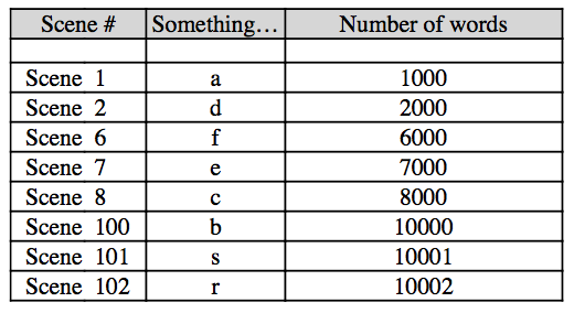

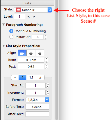

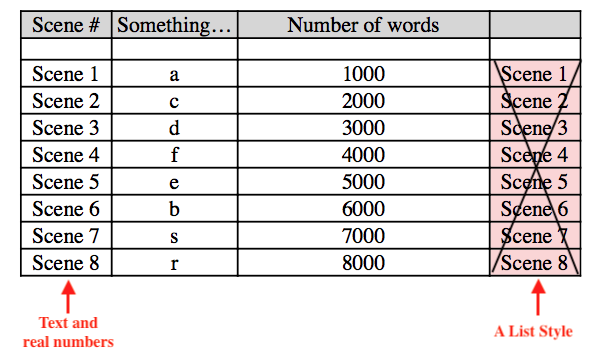

If you are talking about numbers generated by a list style here, then you only need to select the cells in the scene # column and then choose the list style from Format –> Lists –> Scene # (where "Scene #" is a list style that you created for this purpose.) Or, alternatively, select the style name in the List palette, and your scene # column will be magically updated, all in one go. (See screenshot no. 2)
But as I already said, a better approach is to use real numbers. (See screenshot no. 1)

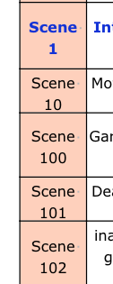

But after I downloaded and ran the macro, which beautifully made a list of Scene numbers in column 1, when I:
a. Sort for number of words.
b. Then sort again for Scene # to return to sequential, I get:
Resort of 1st column -- Screen Shot 2019-07-09 at 11.33.14 AM.png (15.31 KiB) Viewed 41613 times
As you can see, the numbers do not sort correctly, since they should go from 1 to 134, in sequence.
Can this macro be edited to produce numbers in a way that will sort in sequence in the table?
I don't really need the word 'Scene' at the start, would tha help? Or using 1.1, 1.2, etc.? Or some other workaround?

withoutFeathers wrote: ↑2019-07-09 10:41:14 I don't really need the word 'Scene' at the start, would tha help?
Exactly. "Numbers" of the form "Scene 1" are sorted alphabetically. So "Scene 101" will precede "Scene 25" which will precede "Scene 9". They would need to be 0-padded to sort correctly. But if you remove the "Scene " then they will sort as numbers.

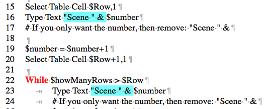

withoutFeathers wrote: ↑2019-07-09 10:41:14 Can this macro be edited to produce numbers in a way that will sort in sequence in the table?
Yes, just remove "Scene " & from the macro.
Turn line numbers on, and you'll find the string on line 16 and 23.
