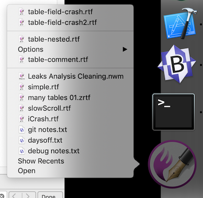

martin wrote: 2019-05-22 09:11:40have you tried using the menu File > Open Recent > Clear Menu?
I have many times... it never works to clear the dock menu like it does in other apps. I gave up long ago trying to figure it out.
Below is my doc menu from a fresh system install of Hi-C Error and Nisus 2.1.10 (no restores from backup). You can see the "dot" files that I initially edit after installing Nisus. Its been that way for months even though I regularly clear the recents menu.
