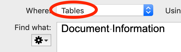

Re: How to search for a 1 cell table
Posted: 2019-04-09 13:37:42
There's an easy non-macro way to accomplish the same task:
1. Use the Find panel to select the desired text. If you only want to match text inside of tables then set the "Where" option to Tables:
2. After you've found the matches use the menu Table > Delete > Table. That will completely excise the enclosing table or tables.
