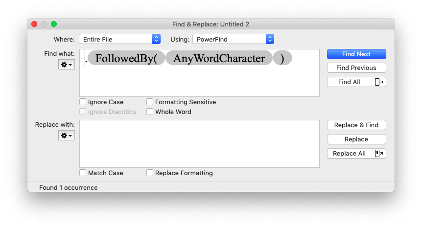

first let me make one important fix to Vance's basic idea. You shouldn't use the AnyTextCharacter wildcard. Spaces count as text characters and you are seeking to eliminate periods not followed by space. So you should probably use AnyWordCharacter instead.
Now let's talk about the whole capture thing. It is indeed the case that the captures that you put in the Find box result in a series of numbered variables. And it is also true that if you use Captured1 multiple times in the Replace box that you will get that part duplicated. And using Capture brackets in the Replace box is obviously not going to work at all, they serve no purpose there. What Vance was trying to do is capture the character before and after the period and then keep them in the replace expression. So he used two pairs of capture brackets the first around the first text wildcard and the second around the second. The first bracket pair creates the variable Captured1 and the second the Captured2. I'm not sure why this didn't work for you.
Now I would actually recommend a different approach. First note that you are really distinguishing periods by what follows only: WordCharacter => delete, space (or other?) => keep. Instead of Capture brackets you can actually used the FollowedBy (or NotFollowedBy) brackets. This will absolve you from needing to deal with the capture variables.
That should do it.

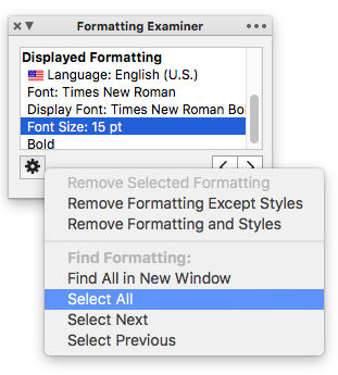

The Formatting Examiner palette
This is a new palette in Nisus Writer Pro 3 that makes searching by formatting very simple. Here's what you do:
1. Select any piece of text that has the desired formatting, eg: font size 15.
2. In the palette's formatting list select the formatting you want to search for (you can select one or more from the list).
3. Click the button with the gear icon to show a menu and use one of the Find commands:

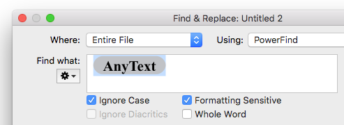

You can use PowerFind (or regex) and the find panel's "Formatting Sensitive" option to match all text with a particular set of attributes. Here's how:
1. Enter a search expression that can match the text characters you're interested in.
If you want to match most regular text (words, numbers, and punctuation) then the (AnyText) bubble works nicely.
2. Select the search expression in the "Find what" field.
3. Use the main menus to apply the desired formatting. This will automatically engage the "Formatting Sensitive" option.
4. Click the find panel's search buttons to select the matching text.
